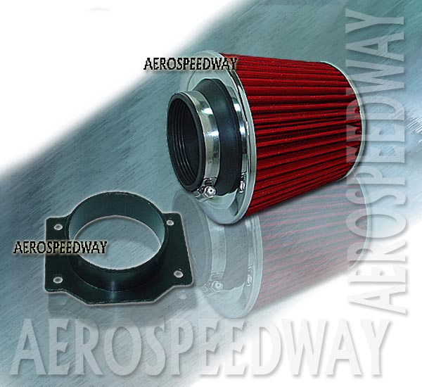

Message Well, I finally got all my parts in to build my own Dual intake, Dual maf setup. Yea I used eBay for parts, but as long as you know what you are looking for and getting it isnt so bad, just have to search and purchase with caution. I used the FAQ guide for wiring to my SAFC.
I also ordered two new 3" filters from eBay.
Along with two 90 degree 2.5" to 3" elbows
Everything installed nicely used a spare MAF I had and began the install. I had to play with the couplers a little to angle the filters correctly, or at least the way I liked them. I measured and cut some metal straps for support and secured the filters so they dont bounce around and my close to final result.
I do notice a difference with the dual maf/intake setup. The car runs smoother and it does spool faster. I also notice the air flow on the SAFC goes to 100% most of the time you touch the throttle, I watch my injector duty on the AVC-R and its normal. My assumption is since the SAFC is set to 2 intake lines and ADD it adds up the two voltages from the MAFs and uses the total on a 5v scale. Other than that I am quite satisfied with a dual intake that cost about $67, since I already had the SAFC. There is nothing wrong with the JWT, SPL, or Ash's Doolz. I just found a cheaper solution that I didnt mind building.
